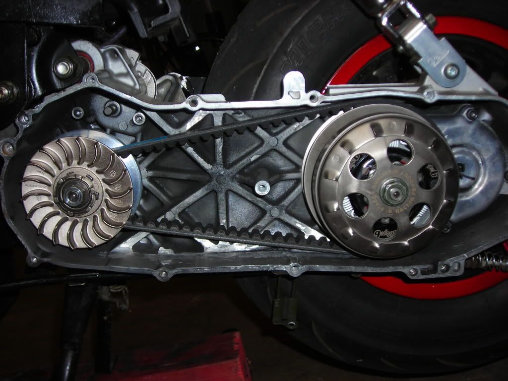

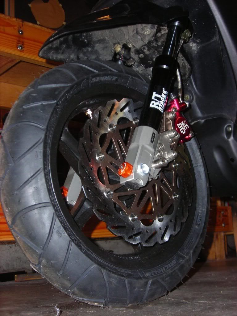

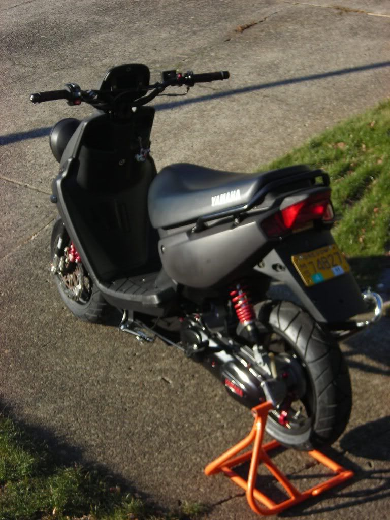

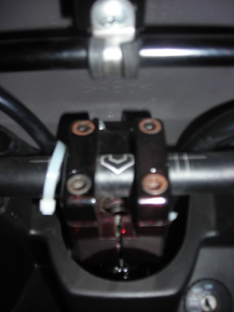

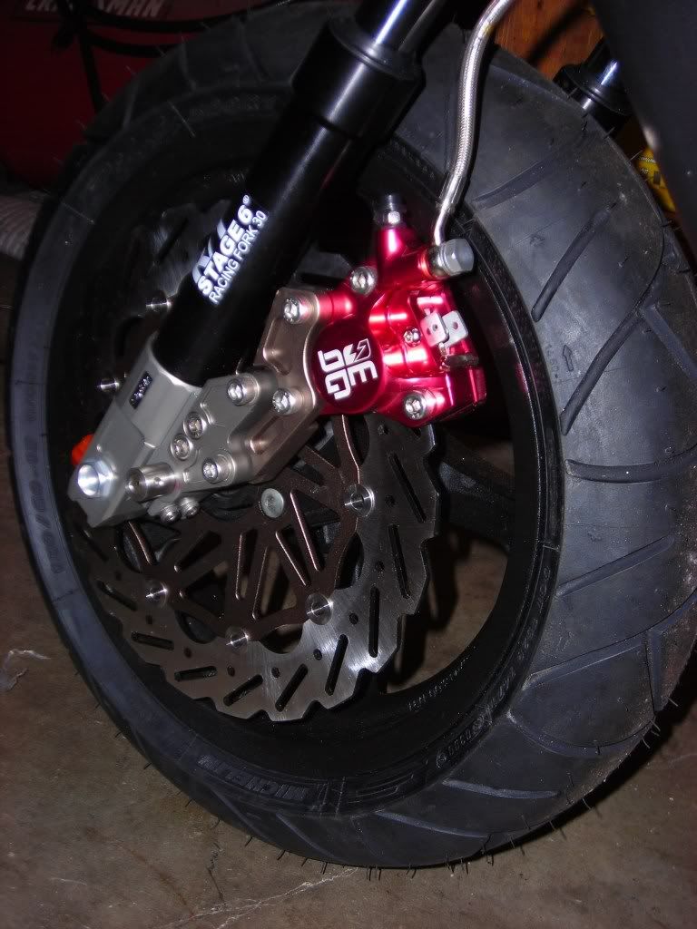

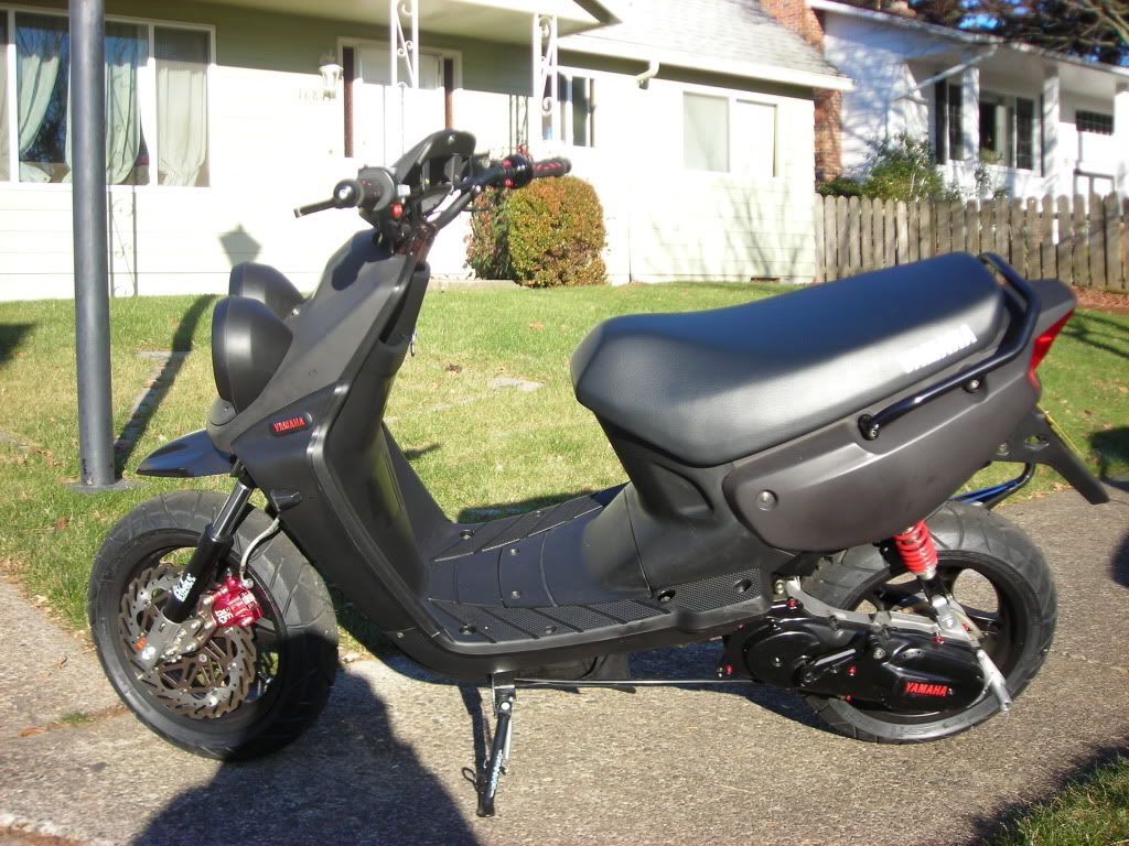

Hello.Some of you may have seen me around some other forums but I like all the great info on this one.Anyway this is my 05 zuma.I bought it brand new and did some small mods.In the last year I found out that there is a semi-local track that allows scooter racing.I checked it out and loved it.Since then I have been inspired to build my zuma for next season.It has so many mods now its hard to list them all.Major points are the aerox wheels,stage 6 forks and brakes.I also had a buddy machine an adapter so I could use a zero offset bmx stem.The bars are cut down motocross units and then I made the barshield out of the stock plastic.I got a throttle off ebay and some stage 6 levers.I shaved the horn vent and high beam light.A lot of people ask why I shaved the light and its because I used to have a R6 and when I bought it it came with a book on the devolopment of the R6.In the pics it showed the test bike with a shaved light.I always thought it looked cool.It sets me apart from other zumas too.The trans has mallossi overrange and stage 6 clutch and bell.Rear shock is bitubo.Huh what else...oh the bump in the seat is shaved and the rack is cut.As of now motor wise its a Mrp 70cc,carbon reeds,oko 21mm carb.Pretty weak.Im building a motor now.I have a Mhr cylinder and kundo f1 exhaust.I just ordered a Mhr crank and stage 6 reverse intake spacer.So all I need now to complete the engine is reeds,subframe,carb,bearings,and some port work.Well thats about it.Thanks for reading. Image Image Image Image Image Image Image Image[/img]

The Malossi overrange pulley looks badass with that minimal clearance in the case.

sanjuro62 wrote:The Malossi overrange pulley looks badass with that minimal clearance in the case.
Thanks,It kinda sucked too.Grinding the case wasnt that bad but I clearanced the gear cover while it was bolted to the case.Turned out good though.I suppose thats all that matters.

Postby mikal » Mon Dec 21, 2009 12:47 pm
Very nice, but I never did any grinding to get my overrange pulley in?

mikal wrote:Very nice, but I never did any grinding to get my overrange pulley in?
Thanks.I had to grind mine.If I didnt the belt would hit the case and the rear pulley wouldnt fit because it hits the gear cover.I might of even spaced it a little.It been awhile since I did the mod but you can kind of see in the picture where I had to grind.

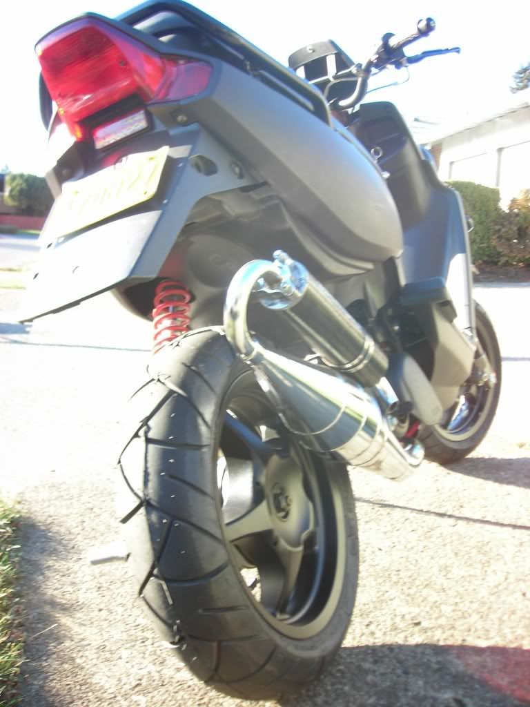

Thought I would do some updates.I almost have everything I need to start building the motor.Just tying up some things before.The stage 6 subframe I got was too wide to fit a zuma frame so I had to cut and weld the stock and stage 6 subframe to make one that will work.Mocked everything up and seems everything fits.Here are some pics. Image Image Image[/img]
